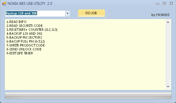

Posted November 20, 201114 yr comment_7843 Full credit to Mr.Fr3nsis Attached a tool which is multi tasking utiilty for BB5 phones. 1-READ INFO All phone information's like Model , IMEI ,sw version , sim lock condition 2-READ SECURITY CODE Security code reading 3-RESET BB5+ COUNTER (SL2,SL3) Do not venture this - i have not tried this 4-BACKUP 120 AND 308 This is the IMEI back up area in the phone - Use full for those in BB5 phone repairing. 5-BACKUP PM SECTORS Same as above 6-BACUP FULL PM (0-512) This can be done .This is use full to back up phone data when combo memory is erased. Require to remove 308 areas before back up .Can be done with box only. 7-WRITE PRODUCT CODE Every one knows about this 8-SEND UNLOCK CODE Not to venture in to this.Again By BB5 phone repair area. 9-EDIT LIFE TIMER Can be done. All the jobs can not be done at one time . Select the jobs from the drop down menu to perform.2313_.rar

November 21, 201114 yr comment_7872 nice share...+1 is it worked in S^3 device also?...coz i'm trying and get this error... READING .... CHECKING ON NEW POSITION: NOT FOUND! CHECKING ON OLD POSITION: NOT FOUND! CODE CAN BE DEFAULT: 12345 btw...reading phone info worked... :D
