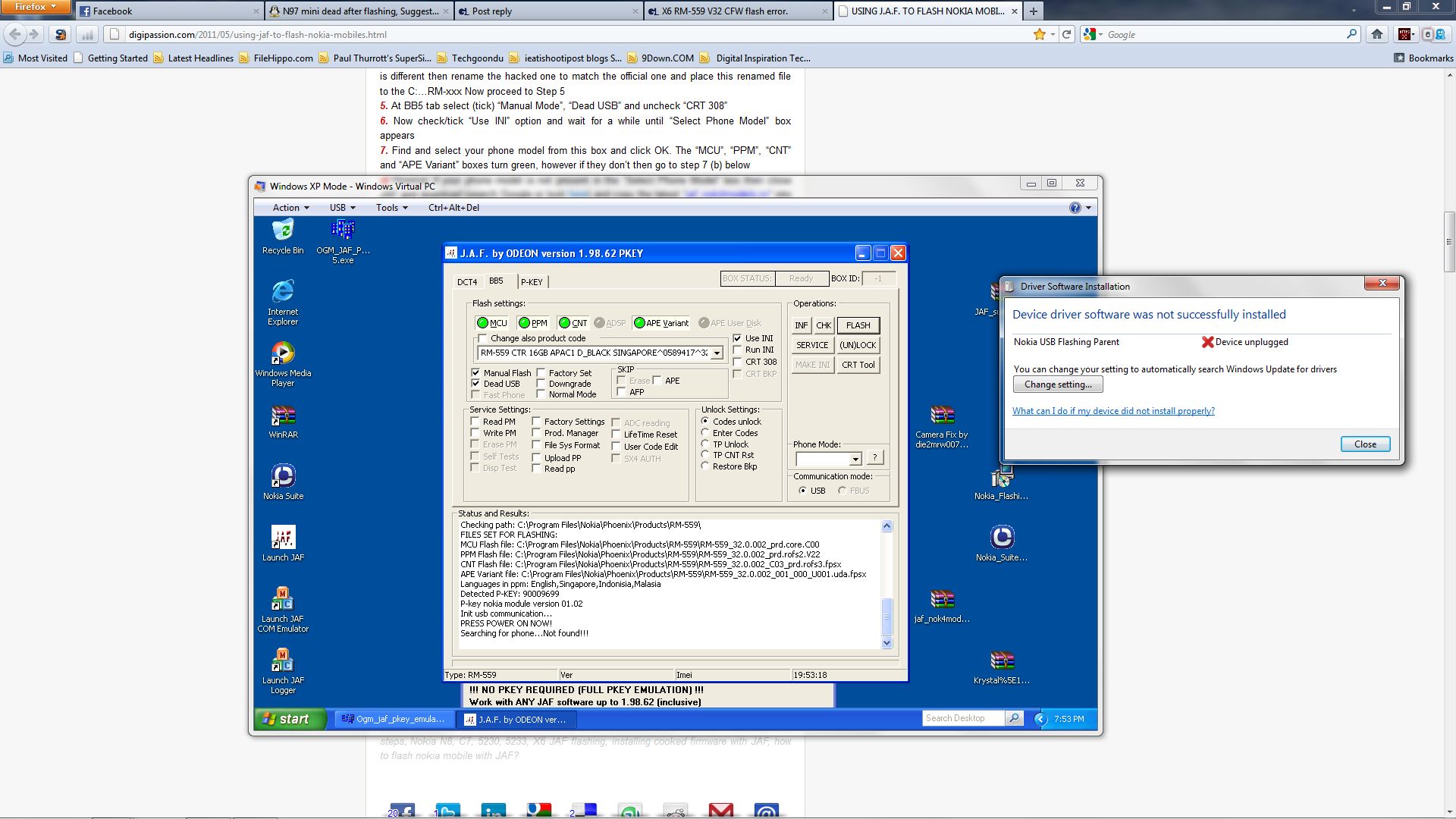

Posted November 8, 201114 yr comment_6729 You may have used lower version core (i belive you didnt, and are aware of this) Its realy a strange issue with your phone. I am much interested to find this strange issue and get with u a working solution. So u are requestd to make a new thread abt this issue and provide all this info in that thread. I will direct my fellow modders and experts over the thread and you probably may get some working solution and we cud find the possible reason for this error. As advised by die2 to start a new thread with all info about this strange issue I'm having with my phone, I have already tried flashing 2 different CFW's using Phoenix since JAF won't work correctly on windows 7 x64, but I keep getting an error every single time the program tries to flash the custom uda.fpsx file. I tried once flashing with the phone 'ON' in normal mode using Phoenix, using OFW and it flashed successfully. But, when I tried flashing in dead usb flashing mode using CFW, it keeps giving an error like the one below here: Flashing started Creating product data items list Product data items list created Backup not required Flashing phone Initializing Scanning image files... Waiting for USB device... Loading secondary boot code: 15232 bytes Secondary boot loaded Loading update server code: 2862577 bytes Update server loaded Asic CMT: Verifying communication to device... Asic CMT: Verifying communication to device... Asic CMT: Start programming 148128 KB... Asic CMT: Partitioning RM-559_32.0.002_prd.core.C00 Asic CMT: Partitioning area 1... Asic CMT: Erasing RM-559_32.0.002_prd.core.C00 Asic CMT: Erasing area 1... Asic CMT: Erasing area 2... Asic CMT: Erasing area 3... Asic CMT: Erasing area 4... Asic CMT: Erasing area 5... Asic CMT: Erasing partition 0x0000000A... Asic CMT: Erasing RM-559_32.0.002_prd.rofs2.V22 Asic CMT: Erasing area 1... Asic CMT: Erasing RM-559_32.0.002_001_000_U001.uda.fpsx Asic CMT: Erasing area 1... Error ERASE_AREA: 0x09E60000 - 0x0F71FFFF Asic CMT: Error in sending data from RM-559_32.0.002_001_000_U001.uda.fpsx. Protocol 1: Error during Flashing. Unable to continue. Unable to flash phone 0x84012281 Starting to recover the phone Recovering phone Initializing Scanning image files... Asic CMT: Verifying communication to device... Waiting for USB device... I appreciate if anyone can figure out what is blocking my phone from being able to flash CFW, please note that I have already installed ALL the required software- Nokia Suite and all drivers fully up-to-date. I will post the JAF log from my other Win xp sp3 system shortly.

November 8, 201114 yr comment_6763 JAF version 1.98.62 Detected PKEY: 90009699 Card life counter: 99.99% P-key nokia module version 01.02 FBUS INTERFACE NOT CONNECTED!!! USB Cable Driver version: 7.1.48.0 Changing mode...Done! FILES SET FOR FLASHING: MCU Flash file: NONE PPM Flash file: NONE CNT Flash file: NONE APE Variant file: NONE Detected P-KEY: 90009699 P-key nokia module version 01.02 Init usb communication... Phone Type: FILES SET FOR FLASHING: MCU Flash file: C:\Program Files (x86)\Nokia\Phoenix\Products\RM-559\RM-559_32.0.002_prd.core.C0r PPM Flash file: NONE CNT Flash file: NONE APE Variant file: NONE Detected P-KEY: 90009699 P-key nokia module version 01.02 Init usb communication... Phone Type: FILES SET FOR FLASHING: MCU Flash file: C:\Program Files (x86)\Nokia\Phoenix\Products\RM-559\RM-559_32.0.002_prd.core.C0r PPM Flash file: NONE CNT Flash file: NONE APE Variant file: NONE Detected P-KEY: 90009699 P-key nokia module version 01.02 Init usb communication... Phone Type: FILES SET FOR FLASHING: MCU Flash file: C:\Program Files (x86)\Nokia\Phoenix\Products\RM-559\RM-559_32.0.002_prd.core.C0r PPM Flash file: C:\Program Files (x86)\Nokia\Phoenix\Products\RM-559\RM-559_32.0.002_prd.rofs2.V22 CNT Flash file: NONE APE Variant file: NONE Languages in ppm: English,Singapore,Indonisia,Malasia Detected P-KEY: 90009699 P-key nokia module version 01.02 Init usb communication... Phone Type: FILES SET FOR FLASHING: MCU Flash file: C:\Program Files (x86)\Nokia\Phoenix\Products\RM-559\RM-559_32.0.002_prd.core.C0r PPM Flash file: C:\Program Files (x86)\Nokia\Phoenix\Products\RM-559\RM-559_32.0.002_prd.rofs2.V22 CNT Flash file: NONE APE Variant file: C:\Program Files (x86)\Nokia\Phoenix\Products\RM-559\RM-559_32.0.002_026_000_U01.uda.fpsx Languages in ppm: English,Singapore,Indonisia,Malasia Detected P-KEY: 90009699 P-key nokia module version 01.02 Init usb communication... PRESS POWER ON NOW! Searching for phone...Found No write data, skiping write... Sending RAW loader... Using ô5~_012.005 Elf2flash 09.11.000 CMT RAW loader... Patching RAW boot step1... Patching RAW boot step2... Patching RAW boot step3... Sending RAW Loader... ....................Loader Sent! Stage 2 starting................PUBKEYS already sent... PUBKEYS already sent... PUBKEYS already sent... PUBKEYS already sent... ..........Phone prepared OK! Waiting for the phone to boot... Searching for phone... Status byte: 8000 Selecting CMT flash... Result: 0000 Phone is in flash mode... CMT blocks: 631, APE blocks: 0 Erasing cmt... Processing C:\Program Files (x86)\Nokia\Phoenix\Products\RM-559\RM-559_32.0.002_prd.core.C0r... Erasing cmt zone 00040000 - 00082FFF ... Erase result: 0000 Erasing cmt zone 00083400 - 003FFFFF ... Erase result: 0000 Erasing cmt zone 00400000 - 007FFFFF ... Erase result: 0000 Erasing cmt zone 00800000 - 00D5FFFF ... Erase result: 0000 Erasing cmt zone 00D60000 - 0B71FFFF ... Erase result: 0000 Partition result: 0014 Processing C:\Program Files (x86)\Nokia\Phoenix\Products\RM-559\RM-559_32.0.002_prd.rofs2.V22... Erasing cmt zone 02EC0000 - 0B61FFFF ... Erase result: 0000 Processing C:\Program Files (x86)\Nokia\Phoenix\Products\RM-559\RM-559_32.0.002_026_000_U01.uda.fpsx... Erasing cmt zone 09E60000 - 0F71FFFF ... Erase result: 0100 Send CMT CFG... Writing cmt... Processing C:\Program Files (x86)\Nokia\Phoenix\Products\RM-559\RM-559_32.0.002_prd.core.C0r... Sending CMT HASH for ADA Sending CMT HASH for KEYS Sending CMT HASH for PRIMAPP Sending CMT HASH for RAP3NAND Sending CMT HASH for PASUBTOC cmt->PAPUB_CERTIFICATE_DATA_BB5 block detected cmt->PAPUB_CERTIFICATE_DATA_BB5 block detected cmt->PAPUB_CERTIFICATE_DATA_BB5 block detected cmt->PAPUB_CERTIFICATE_DATA_BB5 block detected, sending... cmt->PAPUB keys already sent... Sending CMT HASH for SOS*UPDAPP Sending CMT HASH for SOS*ENO Sending CMT HASH for SOS*DSP0 Sending CMT HASH for SOS*ISASW Sending CMT HASH for SOS+CORE Sending CMT HASH for SOS+ROFS1 Processing C:\Program Files (x86)\Nokia\Phoenix\Products\RM-559\RM-559_32.0.002_prd.rofs2.V22... Sending CMT HASH for SOS+ROFS2 Write result 27: 1701 Processing C:\Program Files (x86)\Nokia\Phoenix\Products\RM-559\RM-559_32.0.002_026_000_U01.uda.fpsx... No write data, skiping write... Rebooting... Finishing CMT session... Restarting CMT... Pooling phone... MCUSW: V ICPR72_10w42.1.2 17-03-11 RM-559 (c) Nokia APESW: V 32.0.002 VariantSW: V 32.0.002. Prodcode: 0598934 Done! This is my log of successful flash with nokia x6 RM-599.... just for reference
November 8, 201114 yr Author comment_6780 Damn, phone won't power on after that Phoenix error the other day, here's what happens when I try to plug my phone in and press power on:
November 8, 201114 yr comment_6783 Damn, phone won't power on after that Phoenix error the other day, here's what happens when I try to plug my phone in and press power on: Hey i got it. . .its nt ur phone fault or jaf. . .its completely due to driver issues. Your pc is not accepting certain drivers required for ur phone. Please disable the antivirus while doing this process
November 17, 201114 yr comment_7520 Damn, phone won't power on after that Phoenix error the other day, here's what happens when I try to plug my phone in and press power on: Don't ever flash a phone in a Virtual Machine! JAF works on Windows 7 too. No need for XP Mode.
