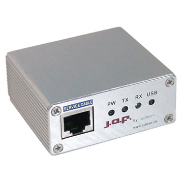

December 4, 201213 yr comment_59989 no you can't downgrade the only way is using a BOX ....... by using a box means by box drive?if really possible will u pls teach me? Report
December 4, 201213 yr comment_59997 by using a box means by box drive?if really possible will u pls teach me? box means JAF box...... it is not a driver...... it is a machine..... looks like this..... Report
December 6, 201213 yr comment_60102 box means JAF box...... it is not a driver...... it is a machine..... looks like this..... is there any way to remove the no driver error when jaf starts? Report
December 7, 201213 yr comment_60140 is there any way to remove the no driver error when jaf starts? Are you talking about "Box Drivers Not Installed" error ?? If so, then don't worry. Simply press 'OK' and JAF will start and you'll able to flash your phone. Report
